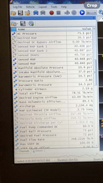

Sensed map seems to be the most accurate. @Jon-MooredPerformanceLLC cam confirm.
6,953
17,964
On my 170 I log MAP, Sensed MAP, Pressure Ratio, Aircharge, and have a custom PID called "BOOST" in chart data. I also log Barometric pressure as it's needed to calculate actual pressure in most cases. They're all with in 1psi.
I think @fumanchu182 gave me a tip on setting up the "BOOST" PID since it's custom and actually reads one of the MAP sensors (from memory) and subtracts BARO from it.
Could it be something with the MAP sensor scale?

Problem is sae channels will not read over 37psi. Sensed map is not an sae thing parameter.

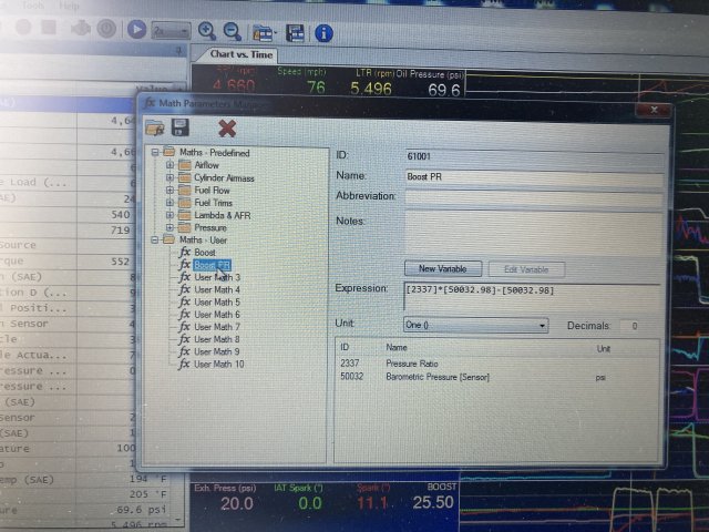

I’m going to try this somebody turned me onto on the other forum
6,953
17,964
That's what I did, only to get a little more accuracy I used the formula:
Pressure Ratio * Barometric pressure - Barometric pressure
3,595
8,456
@Speedy! What symbol do you use for Multiply the Asterix? * ?
Here’s it by IMAP
6,953
17,964
Yep asterisk

Where pressure is read from matters too. Pre-intercooler pressure will almost always read higher than post-intercooler pressure. The difference depends a lot on the temp delta, if you're using ice or a chiller, it's not uncommon to see a pressure difference of 1-2 psi between IMAP and bank 1 / bank 2 pressure readings.
3,595
8,456
I log them all
So 25-26 psi is realistic number?

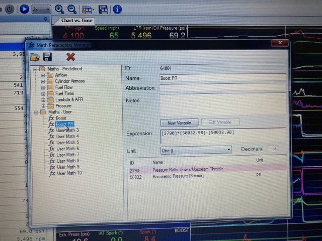

@Speedy! can you post a screen shot of your math page for boost based or PR? I can’t get mine to work that way.
See mine, look right or wrong PR channel?

@Speedy! I found the PR pid but I ca not find the Baro pid you used, I used sensor. Where did you find the Baro pid you used? I’d like to be comparing to a same calculation as others may be using to get an idea how this 2.7 is doing boost wise with my custom plate on it and hand ported snout with a 105 TB
Boost using above pids. 25 psi avg on the pull not bad for a +10 lower 2.74 clutched upper combo with a well used belt. From watching the boost pid I think there’s a hair of belt slip going on, may install a new belt before dyno visit.

You should be able to search for the PID by number.
Also you can run more than one version of HPT on the same computer, so install a newer version for logging new stuff and use older version to open old logs.
