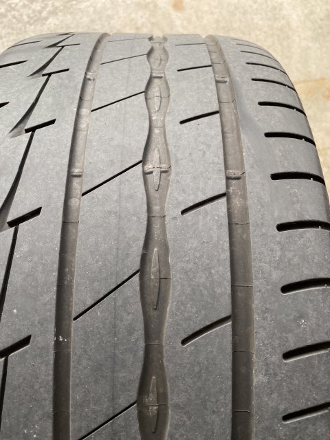

AT this point the rear tires are evenly worn across and stand at 5/32"
The fronts are also evenly worn and are at 8/32nds depth.
Pretty shocking that Ive gotten nearly 20k on the tires and the fronts are barely worn. The OEM Pirelli A/S were worn to the indicators at 30k and the Indys are far far stickier than those could ever hope to be. Looks like Ill get 2 sets of rears to one set of fronts. I can live with that, especially for the price.

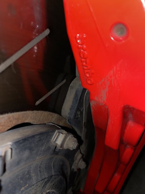

The brake pads are getting low but I can prob ride the winter out with them. Disc's dont look too bad to me, no pulsing or shaking to this day and the car stops hard when I want or need it too so the Z26 pads appear to be far easier on the discs than the OEM brembo pads.

He said, “Disc's dont look too bad to me, no pulsing or shaking to this day and the car stops hard when I want or need it too so the Z26 pads appear to be far easier on the discs than the OEM brembo pads.”
100% agree, great feedback and info after 10k’s miles! And no dust, I will remind everyone.

Nice write-up. One thing you may want to check. The pads tend to wear a bit unevenly...meaning you'll have much more pad on the trailing edge than you will on the leading edge of the pad. So you may want to take a peek at the bottom of the pads.
That being said, it looks like you have lots of meat left on top, but just don't go solely off of the top to determine when to swap them. (Don't ask how I know).

Im glad you said something. I checked and you are indeed correct, there is noticeably more wear on the bottom of the pad. Fortunately the squeelers are on the bottom so Id have had some warning but Id like to change them out before that ever gets close.
Thanks again for the heads up!!!!
