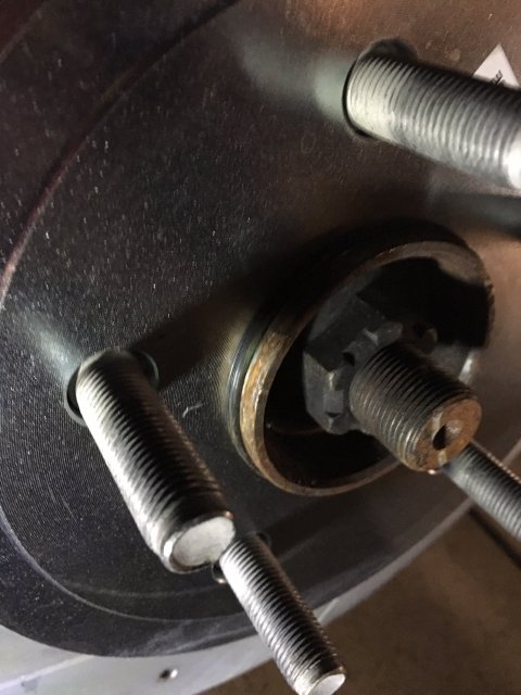

Tools needed:
Rubber mallet, drift punch, channel locks (or something to grab the pins to get them out), jack stand & jack. 22mm socket (I used deep impact socket), breaker bar, and torque wrench. Will also need large screwdrivers to push break calipers back (or the proper tools if you have them) and a small screwdriver. And of course, a socket wrench.
Fronts : 16 mm socket, 13 mm socket, blue loctite.
Rears : 18 mm socket

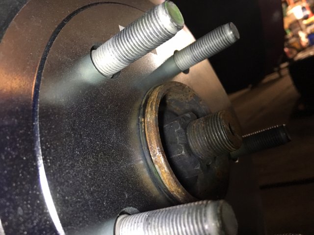

Lessons learned : reuse the pins in the back, ones supplied are too short. Do not reuse the original brackets from brembo, use the ones provided or they will rub (especially the back). There's an o ring/seal that rides in a groove on the backs. It was dark and I didn't see it well. Rotors won't come off without it (pics 87, 89, and 90). The small screwdriver will get them out.
Good Luck out there!
