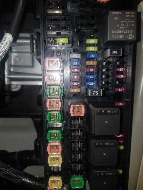

I was told to pop out fuse f37 and f38 and put back in and wait 25 mins.

my fuse cover pannel shows f37 and f38 to be fuse 20A. However, my fuse box itself only shows three different green fuses just labeled 20. Do you know which one I’m suppose to take out?

Hey Stormtrooper, I did as you instructed, but it did not entirely solve the issue. The screen is not frozen anymore but when I open the door the SRT swoosh does not appear. Can you confirm that if you open your door, your speed and rpm gauge lights up with the SRT logo in the Uconnect. This doesn't appear but its not really a big deal as everything else seems to be working fine, I even tested the different drive modes to make sure.
