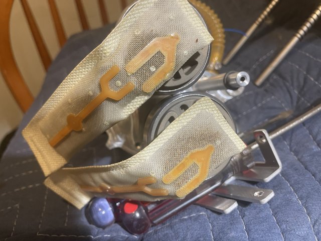

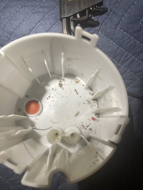

I know most of you already know I should have.My tuner was having trouble with my car maintaining fuel pressure it would drop to 65lbs at wot. I had dual 525 pumps.Well I said maybe the pumps arent enough so I ordered a triple pump set up.Well this weekend I was able to install it and when I took the dual pumps out I was amazed with the trash that was in the basket little pieces of black specs some small some not.And the bottom of both filters were coated with the trash.I bet if I was to clean and replace the same pumps they would do the job.I'm posting this to let you know before you spend your money check everything! Triple pumps are in now though and it's maintaining solid fuel pressure.
