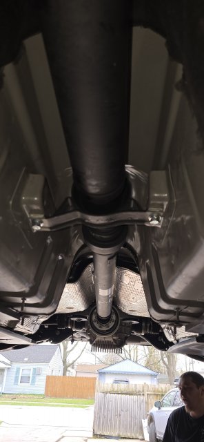

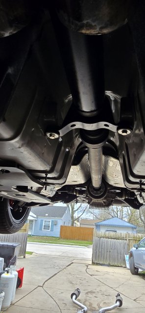

That was the JXB will try to get the stock now View attachment 163648

Looking at it, it looks like the one side is torqued more than the other side

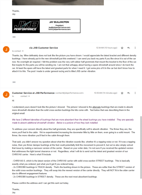

JXB contacted me today with lots of information. They have an updated bushing and a lower bracket that they are sending out. They have a lifetime warranty on their product and it was nice to see the support from them. Glad I got in before the prices went up.

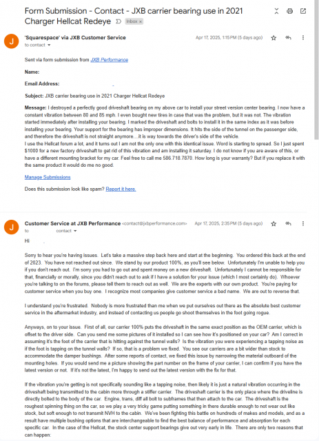

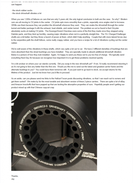

Owner of JXB Performance here. Just wanted to chime in and share our email discussion, so people can see the level of aftersale support we provide and how we stand behind our product. Our entire conversation to date pasted below.
If anybody reading this experiences vibrations with our center support bearing carrier kits, I am an email away at contact@jxbperformance.com. Please do not PM me here or expect a response in the comments; I simply cannot monitor hundreds of different forums. Email is the best way to contact us. Thanks for all the support you've shown Detroitboy and JXB in the comments here. Thanks to Detroitboy for coming in and updating the thread to let people know we didn't leave him hanging.
