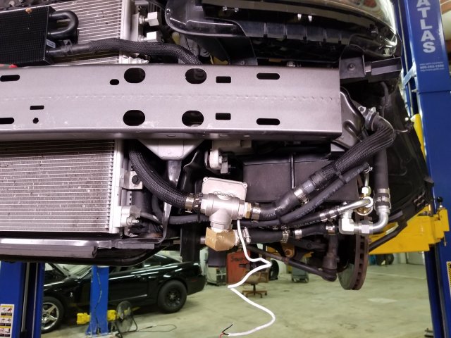

U can run the interchiller with a heat exchanger plumed in the trunk. My old setup had just that!
Do you kept your factory heat exchanger plumbed in? I’m looking for coolant plumbing suggestions
3,319
7,831
Yep, on a 3 way valve. That way if AC f’s up I can still run the factory cooling system.
You can keep ass many HX plumbed inner ass youz want. But like said befoe me. Keep 3 way valvez cunnected 2 redirect in whore outster. Ass 2 youz coolant. You cunt mix gas and inhibant freeon in da same HX.
