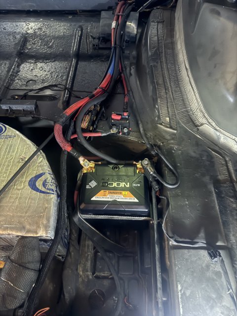

I use this one. Zero issues so far. Just have to keep it on a trickle charger if I'm letting the car sit over a week or so. weighs about 5lbs.
