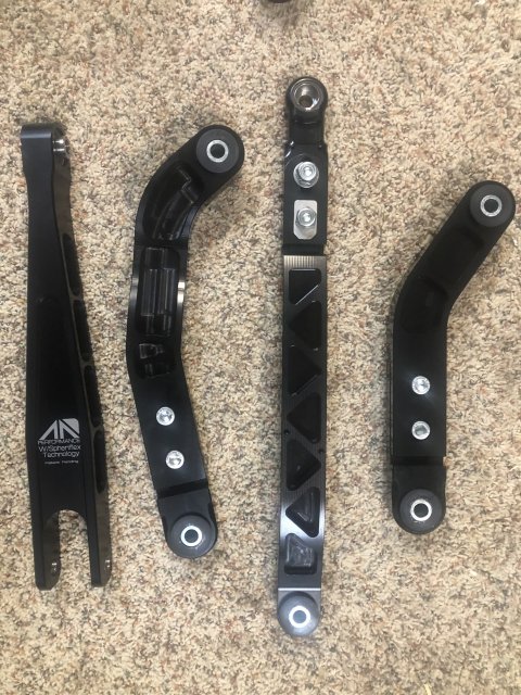

Merry Christmas. Now that you upgrade to AAD.
We see a 15" conversion in your future :) Thus stopping your spinning problems. lol
4,663
24,176

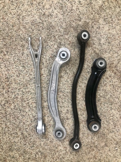

Merry Christmas. I did the trailing arms on my Redeye and that are great.
1,323
10,982
Brooksville
21 Challenger Super Stock
Not a hard install at all, did mine in about 4 hours and I’m old😂

Merry Christmas @Speedy! , Nice gift for Go Man Go, interested to see how they help at the track & the ride quality on the street, normally it'll be a harder or harsher ride on the street ? ... are the bushings polyurethane or Delrin ?
6,696
42,595
@jgilj did you find the #2 tabs were stock settings on alignment?
That is a good place to start on the camber arms @Speedy!. Somewhere between 2-4mm seems to get them nearly flat on the ground. THEN, check those toe settings! I had to have them make me a couple of half degree tabs for the toe arms, but I am being real specific about getting that also near zero. Also a tip my friend, it seems to run the street just fine with the settings everyone likes for the strip. I think Zach sends the set with the recommended tabs installed, so do take note before you change any of them. Have fun, when your ready to change the tabs, on the car, I have some pointers to move the arms around to perform that little trick.
Merry Christmas.
6,696
42,595
IMO BETTER ride on the street over the stock arms/bushings! NOT more harsh for sure. Definite loss of most of the wheel hop. These and new cradle bushings and you really must try hard to hop. What you drag racers like is what us road racers like, these firm up the static camber and toe settings under power. From the look of the rear tires, before and after using these products, it is quite amazing.

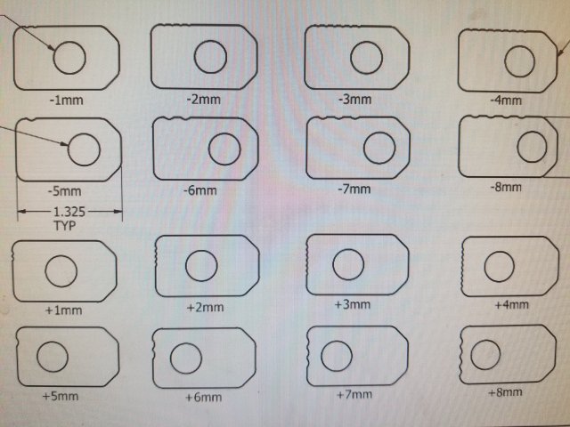

That could be the case. Top out is positive with camber I usually just refer to toe as in or out. The alignment equipment that I was on didn’t even use degrees to measure toe like it did camber. That was one of the confusing things figuring which way I was going with the tabs on the toe settings. My experience was that “in” was more stable going down track than “out”. Zero is desirable but if you can’t get it exact, best to be in rather than out. I ended up with +1mm tabs in my toe arms and -6mm tabs in my upper arms for camber. I have no idea if those would even be close on somebody else’s car. Two big notches on the long side means -6mm in secret AAD code. BB2220A6-BD21-46E6-91A6-0B939B5C449A.jpeg 4E357E4C-49FB-4C07-90B8-EDE939E7DE0F.jpeg

As an addendum to that graphic...in the product description:
Adjustment tabs for our control arms. Please reference the chart when ordering, as this chart may be labeled opposite the polarity (+/-) what your arms might adjust. Current (since 2018) rears and all AAD branded front control arms are opposite (notches on the long side make the tabs longer, e.g. camber more positive). Tabs are sold in sets of 8, are 304 stainless, and should fit all arms manufactured by All Angles Designs / Bender Services Inc since 2012
So for most of us...long side = longer arm...so that 2 big notches would be +6mm over factory...which makes sense going from negative to zero and into positive requires a longer arm.

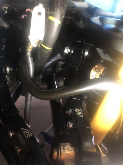

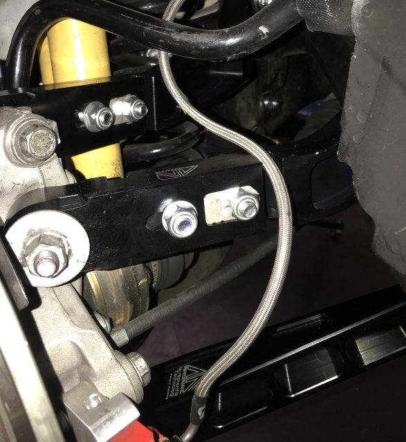

I am sure and have watched your mechanical talents, your good. But when attempting to move the arms and change a tab a couple of things to suggest.
1. When you place a new tab in the slot, it needs something to hold it in while we adjust the arms in order to get the bolt into the new set of holes. Otherwise they will drop to the floor or worse in between the damn lower shock mount! I place the tab in its spot, then cut a piece of blue paint tape. Then tape it in its spot, leaving the hole free obviously.
2. To move them around I use a variety of short rods/punches through the holes, then just use the rod or punch as a pilot and wiggle the arms into position to get the bolt back in. It’s tough from the side of the shock sometimes, so be patient.
3. Just loosen the “other” bolt without the tab on the same arm. Sometimes, I’ll make that one just snug enough to keep the arm in position as I am jockeying with the holes, otherwise sometimes they won’t stay where you want them to before the bolt is inserted again.
4. I also will not tighten either of the top arms while adjusting. It seems if you do, that would interfere with the other arm’s movement.
Of course, do the camber first, then the toe. Camber affects toe, toe don’t affect camber.
Sometimes it is smooth and not a problem, and I feel like a genius. Sometimes, I have wanted to sledgehammer the wheel! But, with refining my technique it got better. Now, after I final set my toe, I am not touching the rear end again! It will be good for anything IMO just set flat and square. Have fun @Speedy!
