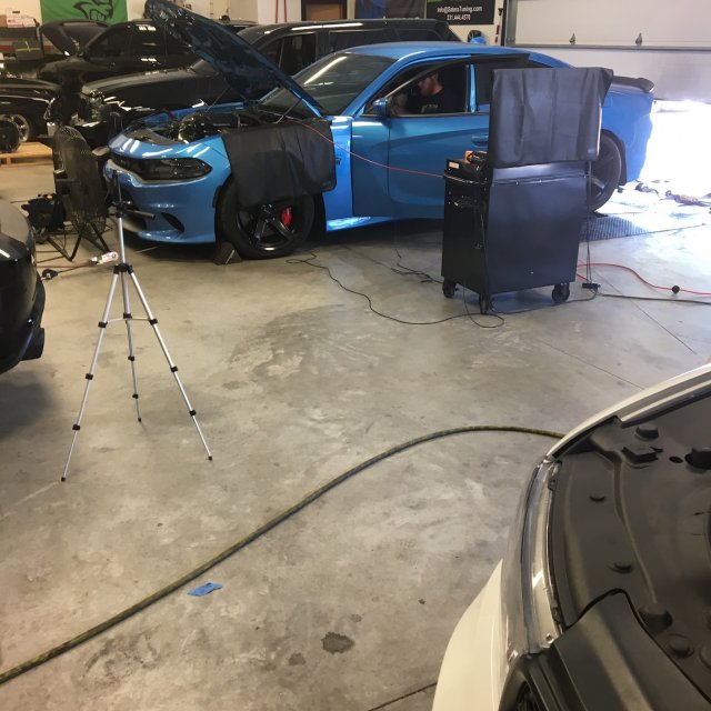

Some of the boost we’ve been playing with. 8BBF51F3-2AD2-4363-96CC-D67A83780327.jpeg AD2D6C64-112A-4E21-9F1C-49B7B92D7CAA.jpeg

I’m not sure how much boost change there would be if we removed the overdrive in the rear. Tuner said it’s very happy at 26. So if he’s good with it, I am. This is being tuned on pump ethanol.

Yes low 80’s. He’s been conservative with timing thus far, which is good. If I can make big power that way I’m good. Curious where boost ends up. I have a cam and headers and was surprised to see it this high. @Primetime Hellcat 17 made 21.5 with .25” bigger pulley. Like I said it was super hot out, maybe blower heat? But the IATs on this thing are crazy low.
