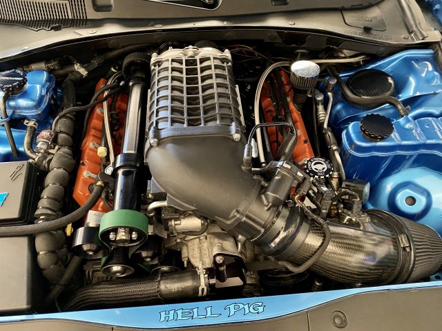

I'd re-route the TB connection to behind the air intake tube.

Thread Starter #147
It has a zip on it. Ain’t going anywhere lol. Behind creates too much of a kink for my OCD. 😂

I’ll be there Thursday evening unless something crazy gets in the way. Weather is looking too good. Last time this happened I only managed 3 runs in 3 hours with how busy it was. Hoping it’s not packed again.....
17,308
54,174
I haven't noticed your painted reservoirs until now.
I normally don't care for the look, but for whatever reason, I like the way yours came out.
Nice job!

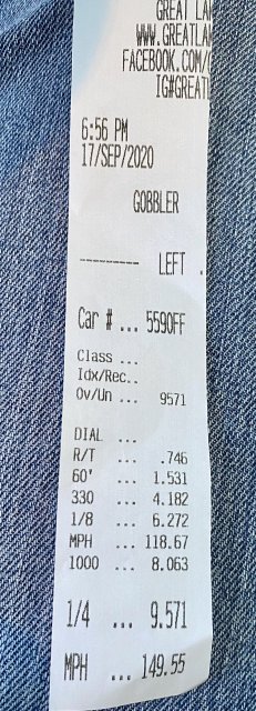

Good to meet you yesterday. Track was a shit show, but got one good run for data in. Can’t wait to get back.
3,630
11,711
Good results Brian. So...... rounding up, you ran 119mph in the 1/8 and 150mph in the 1/4. Stock 6.2 displacement with stock heads and at full weight with the un-ported version of the 2.65 Magnuson. On the first time out! ...... Hello 🤨
Thanks. Yes I’m impressed with pussy footing it out of the hole to grab a log. Tried one more pass and it was a no go, then more people broke. My tuner made some nice changes to the shifts that will send even better. Also found out we didn’t even hit its “peak” for timing on pump E.
Holy Crap
Fantastic results "right off the trailer " !
