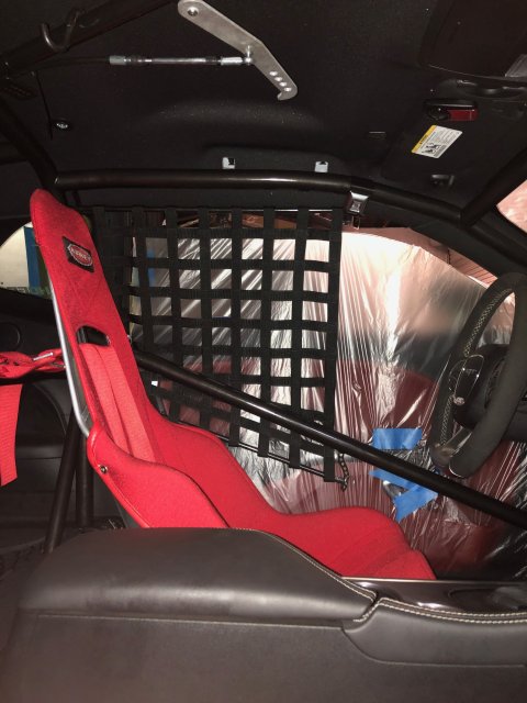

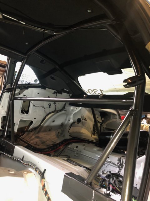

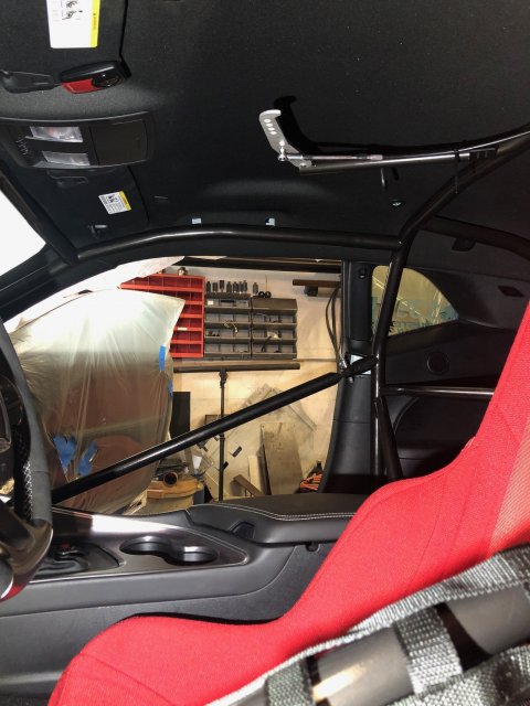

I wrestled with going to a 25.5 but the fabricater said it would go to far with a demon the whole floor would need to be removed and bars added i thought this would bring the value of the car down and the cage i did is for 8.50. i think it will add value to the car the tracks i go to let us slide i only did it for when i travel so i dont waste a trip getting kicked out i plan on getting into the lower 8"s but when i travel i will tone it down.

Looks like some nice work on the cage , I like how they tucked it close to the top of the windshield & A pillars.

I've seen the work personally and I'm impressed with the time and effort to tuck it in tight. It's done very nicely.

@Marc0779, at least in road race cages I'm used to seeing a diagonal bar that typically goes from the passenger floor side up towards the driver's side roll hoop and that intersects the crossbar. Is that not done in drag race cages?

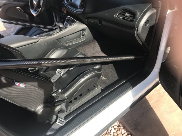

Thanks for the tip. I found exactly what I need for this job at Jegs. Also in case you might be interested..... B00938F7-ADA4-4E0D-8369-1D71C21462E5.jpeg A451BFD2-088A-4D19-9073-61DD1C801FFB.jpeg I’m using the Carbon Fiber caps to protect the paint on some of the bars where they are exposed to wear. They tend to get scratched (like the door bars) and start looking ratty. They are real CF and come in 5ft lengths from A.R.T. (Applied Racing Technology). Keeps things looking new.
