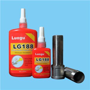

Setup was relatively easy. Operation was easy till I saw every hose leaking on first lift. In the kit they give you a bottle of thread sealer which absolutely does not work.
I redid every hose with PTFE thread sealant tape and not a single leak. Now I wont have to deal with jackstands anymore. I have the 7000SLX models. I do have to call Bendpak as they sent me a extra rail… and yeah um need the space.

No issues with mine but I used teflon tape as well.

This was the fix, threw that liquid stuff in the trash.

If everyone is shit canning the liquid seal, why do they still send it out? Counter intuitive to me, unless it comes with the "package" they set up with Alibaba/Communist Walmart. Stuff is made in China, I believe.

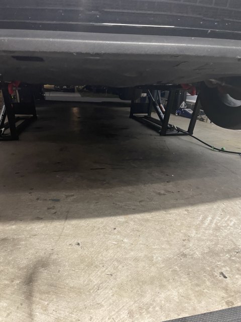

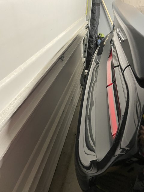

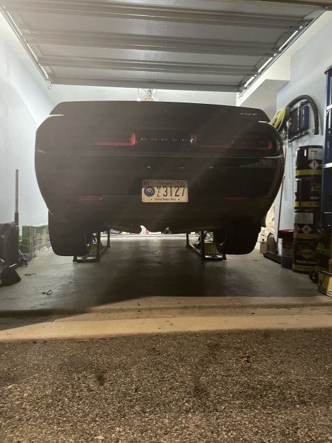

Permanent location of pump and cable route. Also figure out radial shift and storage.
