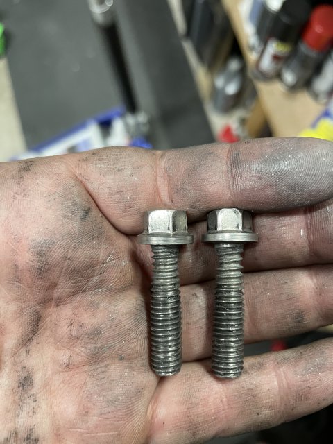

Today when doing my beadlocks this happened twice during torque sequence.
838A366E-815E-4DD0-A126-8A5BAD25D12A.jpeg 0FFF3036-8EA0-4E89-9436-6E751D6C7117.jpeg 2BE7B9C4-1517-4982-81BE-1D0F3DF5C73B.jpeg A5DC94FE-B5FC-44A2-A99C-AF8935CDE3E0.jpeg
Making sure they werent over torqued…
To me it looks like previous owners shop that also failed on the beadlock used ugga duggas, only a matter of time before they went.
If anyone knows a place where you can buy forgestar hardware overnight it would be appreciated. Is it acceptable to use steel hardware with these?

I was thinking about that but the original bolts are aluminum, I’m worried about rust as the two metals don’t play well.
If you use anti-seize on them you don't need to worry about electrolysis. My Welds use steel bolts and have never seen a problem using them.

Aluminum? I have a set of D5 beadlocks and I thought the hardware was stainless.??
3,968
9,809
Thread Starter #15
the reason i said aluminum is because i tried hitting it with a magnet and it did nothing. i guess that really depends on the stainless alloy and how much iron is in it.

Sorry to see this. That really pisses me off- major hazard on top of the tire not seated correctly. The Forgestars even came with a sheet that said torque by hand only with a huge safety warning in red underneath. From the look of the thread stretch https://www.titanmotorworks.com did not follow that. Glad no one was hurt once again...Will never go back to that place. Shame.
3,968
9,809
Thread Starter #19
its all good now, hardware just arrived and as we spoke before, yeah never go back there
