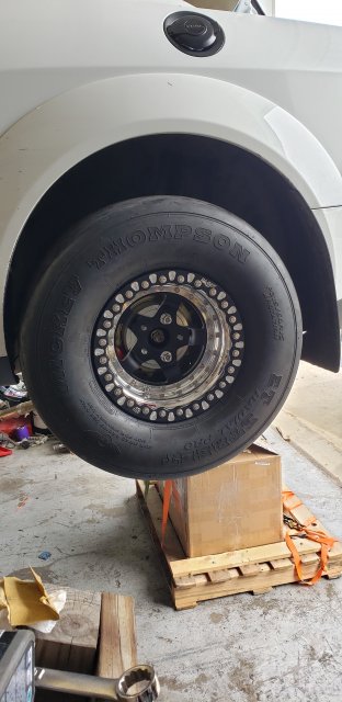

Hole shot wheels in florida made me there first set of wheels 15 x10 inch for my demon 16.2 lbs tire is 315-60-15 mickey pro radial,17 setup should be faster but as the track goes away i will have an option.

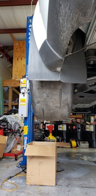

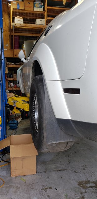

Have Billet Specialties. On 315/17 MT rubbing little inside wheelwell, did you use spacers!

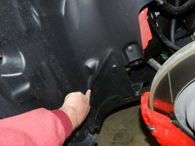

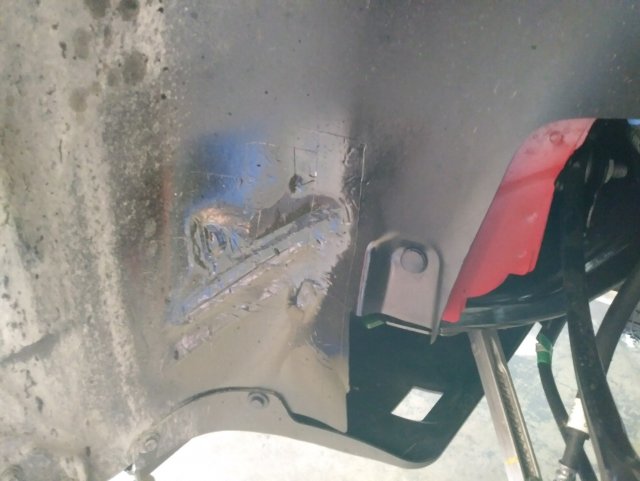

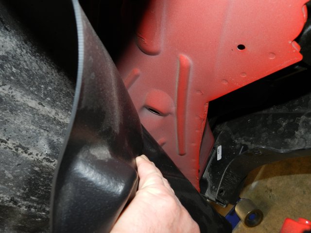

I would double check the back space with a ruler. After that you are going to have to take down that rib. I have done it a bunch of times using different methods. If you don't need much just put some large head rivits in the tub to flush it out with the frame and go at it with a grinder. Plastic, metal and all. Throw some metal HVAC tape over and spray paint it. Simple. No?
