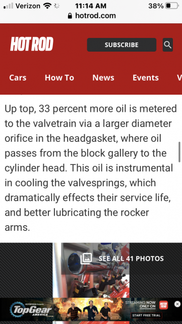

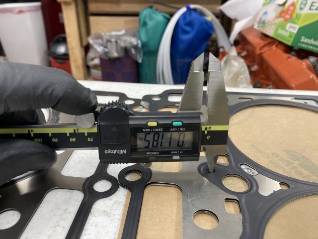

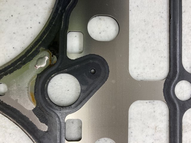

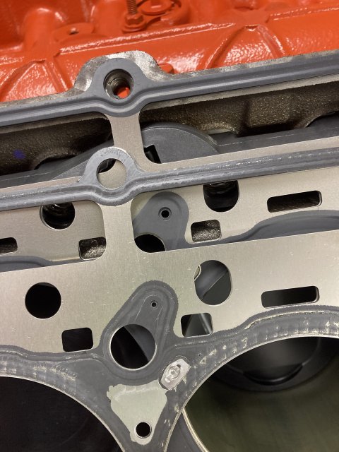

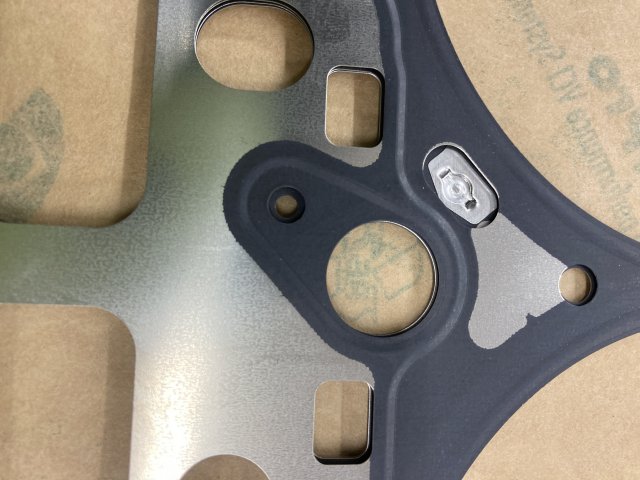

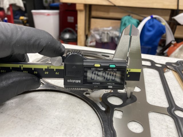

Just the head gaskets, that’s the advertised RE improvement of 33% more oiling to the valve train assembly, the only change was orfice size was increased in the head gasket. Aftermarket head gaskets like the Cometic MLX gaskets still use the smaller orfice size, you have to drill them out if you want more oil up top. It’s why I think some builders have lifter and oiling issues up top because no one notice's this.
