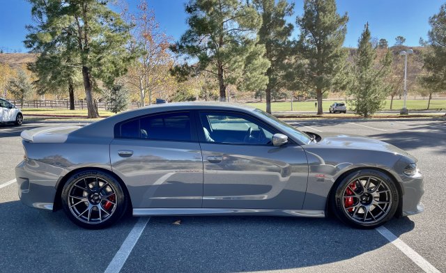

Went with 20x9.5 fronts and 20x11 rears. Michelin Pilot Sports are 275 front and 315 rear...no rubbing.
Edit: Forgot to mention the new rims are about 4 pounds lighter per corner. Stock slingshots were about 29 and Konigs are 25. C7EE37FB-C265-46E8-B30D-7ED3F23EC0B0.jpeg EFE644C8-5DF3-4B54-BA22-A88A4EA07A78.jpeg 631667BD-2446-4BEA-8E45-3A5AD0254172.jpeg

That is about perfect. Good work!

Thank you, I appreciate the compliment.

Those wheels are sweet. Looks great on your color.. hey just one suggestion.. you ever think about painting the Rear Valance.. my car is pitch black and I had them match the Body color.. came out really nice. I could see you painting it either the body color or a pitch black gloss could look nice too. Happy holidays!

Absolutely, I’ve been thinking about painting the rear valance and front mustache for quite some time. Thinking about going quad exhaust tips and painting the new valance...and I’d match the front when it all happens.
Thank you and have a wonderful holiday season.

Good job! BTW do you remember the offsets?

Yes, 18mm for the fronts and 21mm rears.

Taxinator, your set up looks great but the tires you pick the Michelin Pilot Sports are awful for traction purposes. I don't know if you're going for looks or performance either way excellent job.

Thank you. Although the PS4 cannot complete with a drag radial, they are great for an all season. I believe they out perform the stock Pzero and a set of GoodYear Sport Eagle I had prior to the PS4. Compared to these, the PS4 performs well...much better than I anticipated.

That setup looks awesome, pretty similar to my new BC Forged K12’s. Very nice!
