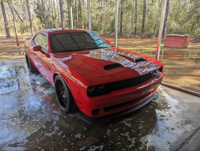

You could always look up the factory wheel and tire sizes for a widebody car...
10,901
30,765
So you have a regular (narrow body) car?
Ever look into Phillips Fender Flares?
Allows me to put 11.5x20 wheels (335x30x20) without them sticking outside the wheel well.

HEY Howie....welcome....word of advice,,listen to Hunter...I have the same set up..(as do a couple of other members..)..it's the only way to go...it looks amazing in person...easy install...a bit pricey..but it wont break the bank...you will be able to run a bigger tire..and it will set yer cat apart..with a low level of difficulty..you will love the look
