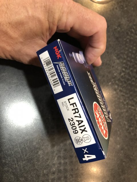

Ngk 2309 vs 7aix+11?
AlleyCat
#1332
801
724
82
Oro Valley
16 HC Challenger
I think they are the same plug. One comes gapped at .031 and the other one is gapped at .045 or so.

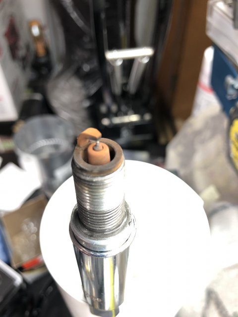

They run nice at 16 psi boost on pump 93 These were run with Torco, Boostane doesn’t make them as orange but burn as clean. ECA44438-C206-4C60-BCF4-FCC8A3116663.jpeg

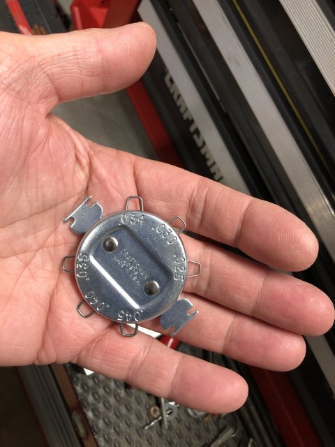

I use this Craftsman one, #40816
3,309
7,798
I use 2 together, one to hold and one to make the tweak with
