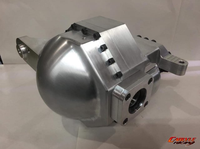

No they are not compatible with the stock rear end. You have to do a complete conversion like this,,,, 1E403562-0A8A-4C1F-A72A-791990F9807B.jpeg

No they are not compatible with the stock rear end. You have to do a complete conversion like this,,,, View attachment 7642
This picture gives me the urge to do many irresponsible things.
Being a Ford 9", would they not be incompatible with stock pumpkins?
That's a reasonable question, and one that I have had as well. Given the cost of the conversion, it seems to be very expensive for that center section, and since Ford 9 inch rears are very plentiful, I have a hard time understanding the high cost of that center section. Welding on some additional mounting brackets shouldn't run the cost that high either.
Now...before the flaming starts....I'm not a diff expert, nor do I claim to be one. I have a ton of friends that have Ford 9 inchers in their various cars and they're based on the standard Ford 9 inch pumpkin with various axle tube arrangements welded on.
For this conversion, there are no axle tubes or brake concerns, etc. It basically stops at the housing. So where does the high cost come from?
I'd like and 8 3/4 conversion ..... You can get 2.76 gear sets .
I'd like an 8 3/4 conversion and use 3.23's. or maybe the 9 inch and either 3.25 or 3.31 gears.
8 3/4 3.23 gear sets are a dime a dozen......I know where multiple sets sitting on posi units are right now. Of course I would want a nice Auburn posi unit for my conversion.
May a big part of the expense in this is the connections from the diff to the axle stubs. Maybe those have to be specially made.
My POINT was, someone talked about the ring and pinion gears, and it was THOSE I was asking if they were not compatible with the beefier housing.
Wow, those catalysts roasting the rear half shafts.... Is the in-use airflow such that the exhaust tips succeed in pointing their airflow downwards?
That rear end is downright porn... er, PHOTOGENIC it's so tough and industrial-grade.
