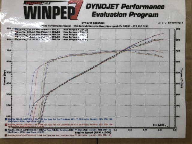

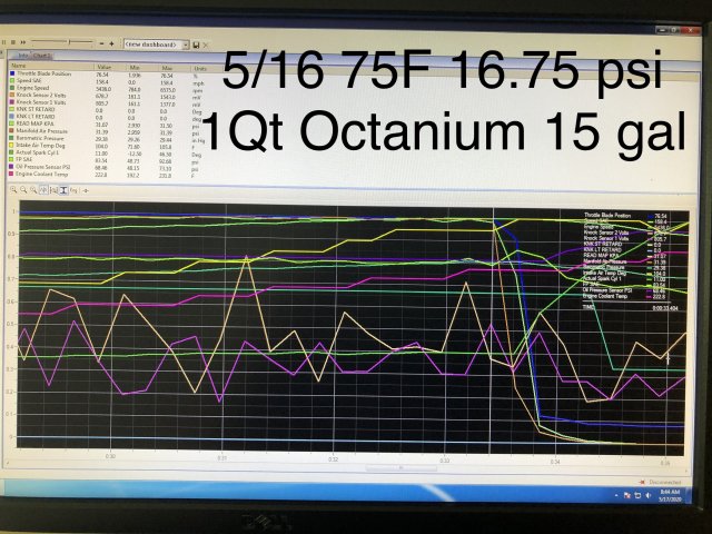

I swear by Octanium Unleaded, I used Torco in the past on other cars it leaves lots of orange soot, Boostane ehh, Octanium? The shit works period. Cut my Knick sensor volts in half and I’m running 16.5 to 17.5+ psi of boost in good air on Sunoco 93 and put down almost 860 wheel. Data don’t lie B24CC5F2-770E-4B7C-980B-209846A44096.jpeg D603471A-75B1-44D9-A654-D258EC1CD26A.jpeg 0CD05CBC-A4F5-46B9-84B6-8912139B9D50.jpeg

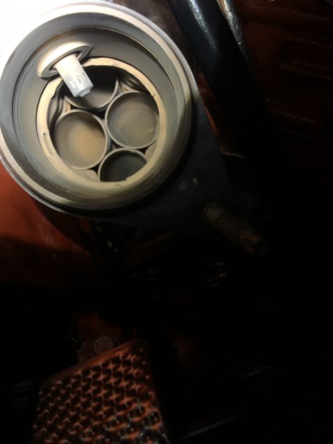

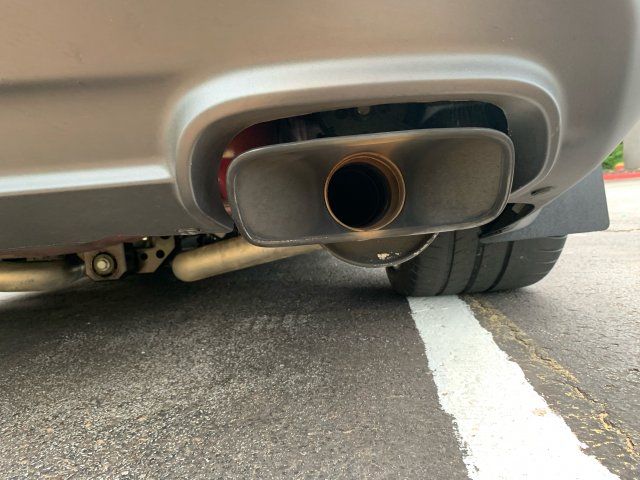

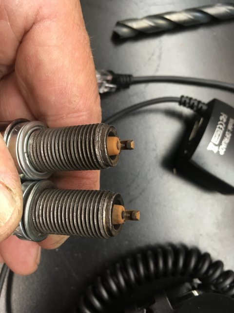

Looks like Octanium uses MMT as a lead substitute, like Boostane does. MMT is what leaves the orange residue behind after the combustion process. MMT, like lead before it, resists detonation and raises octane level...
Section 3.1 shows MMT
https://www.marcnelsonoil.com/wp-content/uploads/2019/04/VP-Octanium.pdf

It does leave some orange residue but nothing like Torco leaves and half as much as a Boostane. I pulled my pipes after 10 or so tanks of it to see, plugs looked decent as well 8C7E3C66-BFC3-4C08-B321-1E02D6D41F1E.jpeg 62DA831A-F004-4755-A54C-30E909727382.jpeg 6C68654D-729D-4C48-B17A-3F60463020A2.jpeg
