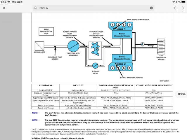

Question - I've received this code along with the dreaded P1620 on a few quarter mile passes lately. Since I'm pulling the blower to install spacers/blanket I plan to replace the offending TMAP sensor.
Can anyone confirm which of the 4 sensors "sensor 3 bank 1" represents?
When I look up P00EA, it references the sensor on the driver side, middle of the blower (intermediate TMAP). However, when I looked up the supercharger removal procedures the sensor on the front of the blower on the passenger side is referred to as 'bank 1'.
Want to make sure I replace the correct sensor.

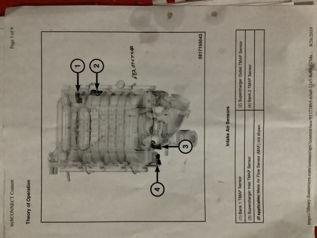

Thanks, I hadn’t seen that diagram.
However, I’m still not sure which of the 4 sensors the code is for... looking up the DTC, it calls out the intermediate TMAP sensor (#2 above). The ‘bank 1’ sensor is called out as #1 in the diagram above. And the Dodge service manual refers to #4 above as the ‘bank 1’ sensor.
I’m so confused...

Found this which appears to confirm its the intermediate TMAP. I’ve already got one inbound, so may just replace and see if that takes care of it for now.
