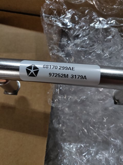

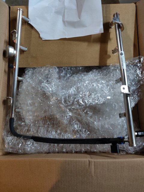

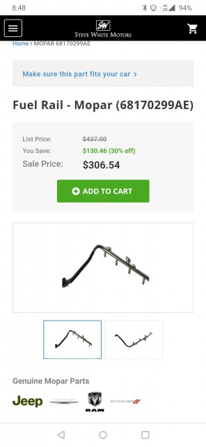

I was caught off guard by the fuel rail as I did not expect to receive the right side fuel rail. Even the picture of the part shows only the left side and center piece. For future reference if anyone comes across this thread, this is the part on the website and what I received is pictured above.
