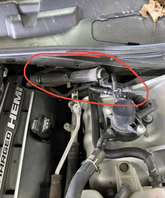

P2C90-CRANKCASE VENTILATION SYSTEM - HOSE "A" DISCONNECTED
This diagnostic runs when the following conditions are met:
  • With the engine running.
  • Engine speed above 1200 rpm.
  • Engine load above 70%.
Possible causes:
CRANKCASE VENTILATION HOSE DISCONNECTED OR LEAKING
CRANKCASE PRESSURE SENSOR NOT FULLY SEATED
Check Driver side hose
Check Airbox plug

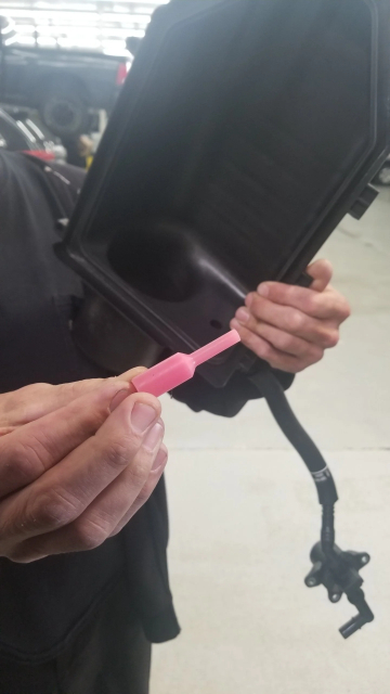

Possible causes:
Check Airbox plug
