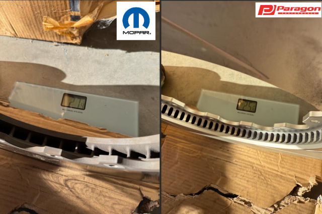

OEM Rings + Hat (est. 31 lbs new and 29.2 lbs worn)
OEM ring: 27.4 lbs (worn, est. +1.8 lbs heavier when new for 29.2 lbs).
OEM hat: 1.8 lbs

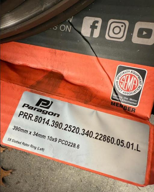

Paragon Dual 2-piece Rotor Front Rings + OEM Hat (est. 27.4 lbs new 390mm and 28.1 lbs 400mm)
Paragon ring: 25.6 lbs (390mm ring)
2015-2020 (390mm): https://paragonbrakes.com/15-4-front-rotor-rings-15-20-charger-challenger-srt-hellcat/) as a direct swap from the OEM hats.
2021+ (400mm): https://paragonbrakes.com/2-piece-r...34mm-21-dodge-charger-challenger-srt-hellcat/
OEM hat: 1.8 lbs

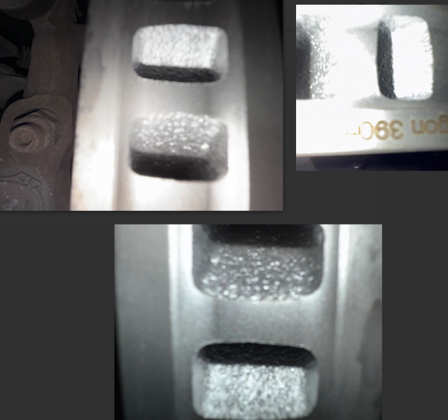

I've got a set of Girodiscs in the shop, I'll get a pic posted later today.

Giro’ outside and inside shots…

Dude! Where's all that rust from?
: p
HA! Not used in I don’t know how many years. Not since 2019 anyway. Left those for dead because they chattered a bit. I know they have not been on the RE. I think they just need hammered real hard because my current set does that (on the track) if you don’t bust down hard all the time.

Girodisc has a straight cut vs. the curved cut of the Paragon.
Paragon manufactures their rotors, given the large variety they have to match with hats.
