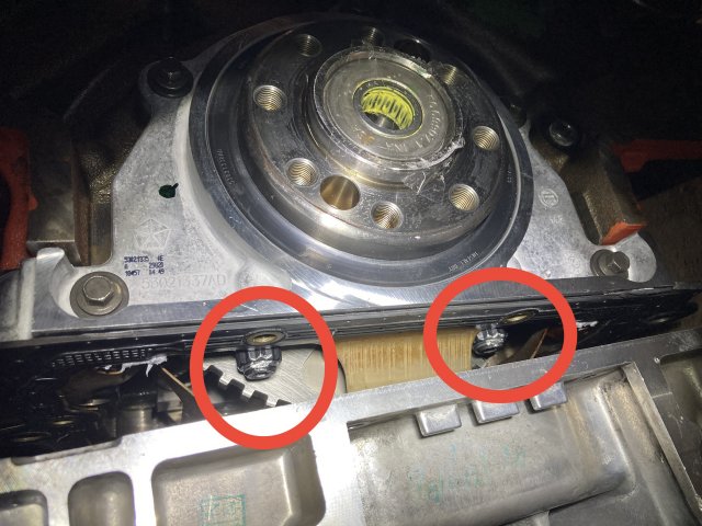

NICE!! Looks like you have billet main caps too ??
When putting your oil pan on the inside of the pan hits the nuts on #5 main cap (dud on mine at least) to where the pan would not move forward enough to be flush with the back of the block. I had to relieve the pan with bur to make room for them. You run into this same issue?

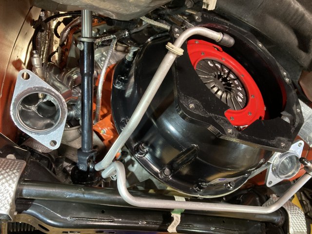

I didn’t notice this until after the engine was in the bay and getting ready to mate the transmission, was a real PITA to remedy in place, Would have been much easier to remedy while the engine was still on the engine stand.

Was this due to the nuts on the ARP hardware? Either way, thanks for mentioning this. Ill make sure to check mine before things go in place
Yes, zoom in on first picture, see the aluminum mashed into the nuts? That’s from the oil pan hitting it.

Mine where stock caps. If the caps have the same height it puts the nut in the same place. The pan went on fine, I would not have noticed this except for when I put my new steel scatter shield bell housing on and checked run out with a dial indicator it was on center but not parallel to the block. Further investigation found out why, oil pan was not flush with the block. Most would never notice this, but I bet it’s an issue on every build done using studs with nuts and not relieving the pan for the nuts. The bell would have mounted and trans stabbed most likely. It would have just produced a misalignment and possible shifting issues. With an auto it would cause a miss alignment at well but the flex plate would help it not be as much of an issue but still not good for the trans either variety. I bet if you check with a flashlight you may find a gap between trans bell, auto or manual, in the same area as shown with a straight edge in picture 2. If those caps are meatier and higher the issue will be even worse as pan is tapered inside and the higher the nuts are the more they interfere with the pan.
There was no flexing this 3/8” thick spun steel bell, an aluminum one may be.

I will have the pan off soon. We are replacing it with a rear sump pan and I’ll take a look to see if there has been any contact there and if that needs to be a consideration with the new one. Thanks.

If it was tightened down and then the transmission bolted to it you’re probably not going to see any rub marks on the nuts themselves, you’ll have to use a straight edge on the back of the block and check everything to be sure it’s all flush, the back of the block, the rear main seal, and the oil pan should all be flush
