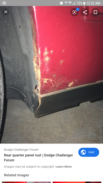

I'm sorry to disagree but I don't want the thread starter or anyone else to think these cars won't rust. Dodge sprays foam in the front of the rear quarter panels and this holds moisture and salt. Causing rust. I've seen pics of late model challengers worse than this. Screenshot_20191010-002257.png

Wow! I am glad the bottom of my rear quarters is not metal. The rear bumper wraps all the way around to the wheel opening.

I'm sorry to disagree but I don't want the thread starter or anyone else to think these cars won't rust. Dodge sprays foam in the front of the rear quarter panels and this holds moisture and salt. Causing rust. I've seen pics of late model challengers worse than this. View attachment 4110
The area most prone to rusting is the (front) of the rear quarters by the doors. Not the rear of the fenders that is plastic 1/2 way up.
