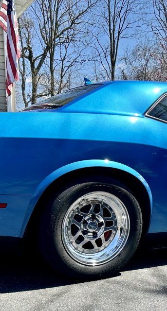

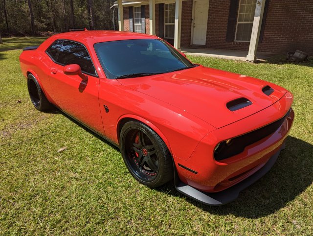

Yup. Phillips flares. You can get them unfinished or painted to match. Latest generation afaik attach with pins in the front and magnets in the rear, at least that’s how mine are mounted.

Mine also.
Make sure you get the magnetic rears.
The tape rears come off / away.
Front are pin / rivet.
I have 20x30x335 on the rear
