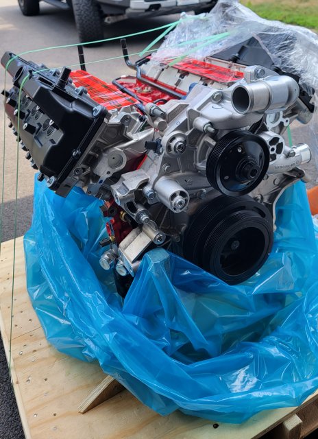

@Speedy! That was me messaging you regarding the Demon/Redeye long block. I also have a 2016 Hellcat mine being a Charger.
When the long block finally arrived it did include the oil pan. The exhaust manifolds had to be swapped over as well as the knock sensors and the oil pressure switch "sensor" because the 2016 connections were changed over in the 18+ models.

Ok, dumb question
Why is the less expensive p/n the more complete unit??
