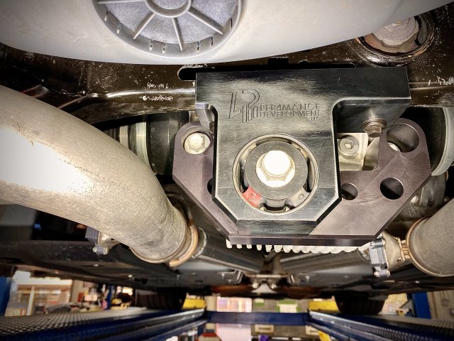

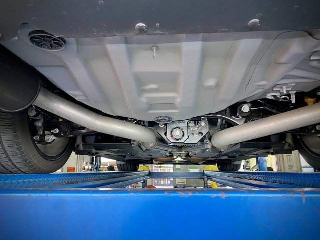

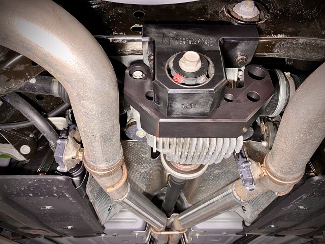

Latest install on my ‘21 Redeye....
Performance Development’s “DIRS” rear DIfferential Reinforcement System. Rated to withstand launches at up to 1000 rwhp. I’m super impressed with how much more “planted” my rear end feels after the install. I’ve only done a few launches and freeway pulls since the install today but I immediately felt the difference. It launches straight as an arrow whereas before, launches could get a bit squirly. Wheel hop is also gone.
I saw enough track launch pumpkin explosion videos, some resulting in $12-$15 in damages, to want to ensure I beefed it up back there on my 3.09 rear diff.
I pulled the trigger and cannot be more satisfied. I’m not affiliated with or getompensation for this post. I simply was so impressed with these folks’ product and costumer service that figured I’d share my experience.
Bray is an amazing guy.
Can’t wait to run a few 1/4’s with this on!
