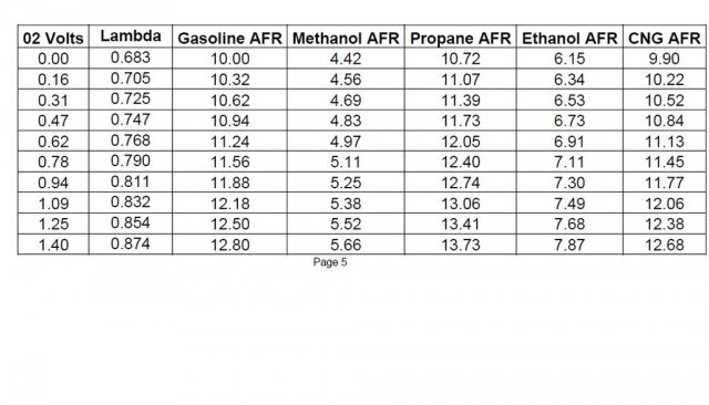

That concept does make it easier to comprehend it, but when I was reading they were giving it an arbitrary number of 1,then adjusting off that number . But is that value different for all fuels? Like does each fuel have it's own value of one to adjust from? Don't want to take up your night. I'll get it.
Lambda is one scale of measure for all fuels and/or fuel compositions. It is the relationship of oxygen to everything else downstream of a combustion event. That isn't to say there is a magic number for all boosted engines (like 0.740 Lambda) you still have to tune for your combination. It is just easier to tweak moving in increments of 10th or 100ths of 1.00. As opposed to doing a bunch guess work on the gasoline scale with other shit mixed in.

Again, I understand the ratio of A/F ratio of gas to the value of 1 the best. Have never even played with the other fuels but I get the ratio's. Like A/F of 12.8 (gas) is 87.4% of the "1" lambda (i.e. the most efficient 14.7 A/F combustion ratio for fuel) . I don't have HP tuners or DS but will prob start playing with that some time in future. I'm guessing they all use this as a bases not A/F? Also, 02 volts?(have no idea) 02 sensor reading? Thanks for the chart. You don't have to feel obligated to be my personal tutor, appreciate the input and info.
I don't mind helping. Typically O2 volts are for narrow band O2 sensors, which Hellcats don't have (but most GM products suffer from (along with open loop tunes)). But, in the case of the HCs they do use Lambda as a basis for their tunes and are closed loop corrected using real-time info from the WB02s.
For anyone venturing into tuning it is important to remember these are oxygen sensors, not fuel sensors. They react to residual oxygen content and don't care what other crap is suspended in the exhaust. Some people get so wrapped around the gas-scale they forget their purpose. These sensors are some of your most powerful tools.

Get used to lambda and your life will be much simpler. It was tricky for me at first as well since I'd been using AFR for a long time, but it'll make sense over time. AFR changes for each fuel type as Motorhead mentioned, so for gasoline stoich is 14.7:1 but for E85 is like 9.7:1. Using lambda no longer requires any conversions as lambda is labmda for all fuels.
For example, the reason you see 13.5ish at idle and cruise is because the stoich point for the Hellcat is set to .0722 from the factory. To convert to AFR divide 1 by this number: 1/.0722 = 13.85. That's basically your base.
Factory power enrichment fueling is .0110 addition. So .0722 base plus .0110 = .0832. To convert again just divide 1 by this and you get 12.01 (that's LEAN to me!! but is what it is from the factory.
I think it's 12.0 from the factory because there's an add'l fueling table that comes in to play called Cat Over Temp (COT). This table is used when the cats hit a predetermined temperature and the car basically dumps fuel to cool them off (this is bad for performance) and I turned this off in my custom tune. When you're getting on it and the AFR displayed on the dash goes from 11.9 suddenly to 10.0 - 10.3 COT has kicked in. Stock in my car this occurred about mid way through 3rd gear.
In my custom tune I call for .83 - .84 lambda (to convert to AFR this time you multiply by your stoich AFR of 13.85)
.83 x 13.85 = 11.49 AFR
.84 x 13.85 = 11.63
It's a tad richer than 11.8 - 11.9 for max power since I turned off COT and provide a bit of safety for so so 93 octane fuel.
