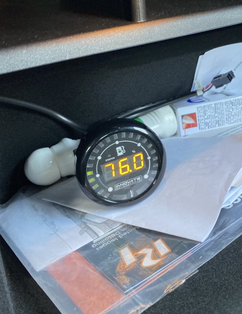

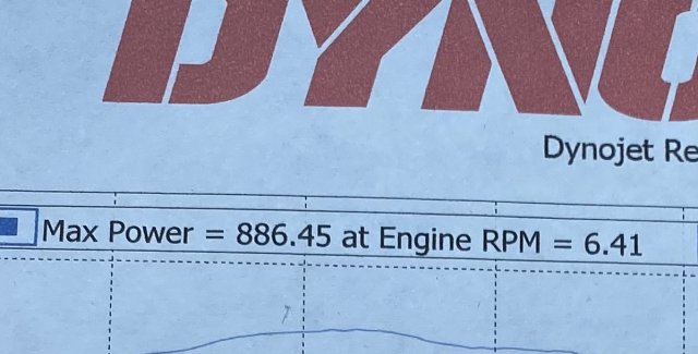

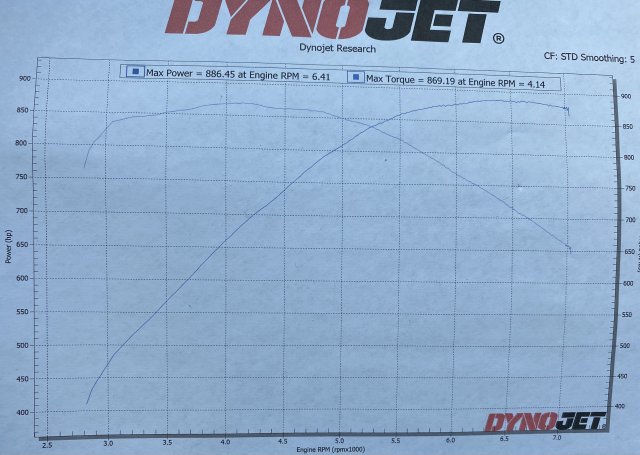

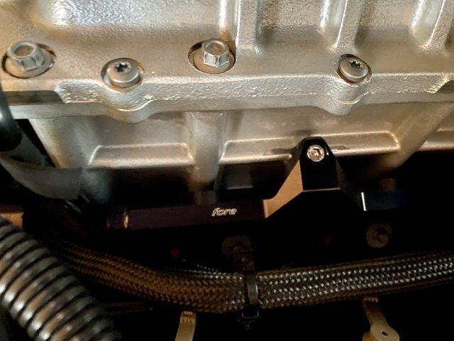

I got my car back today from HHP today. I decided to go with a 2.85 litens and an e85 conversion.
I also wanted an Innovate ethanol content gauge which required Fore fuel rails. This e85 conversion also required dual boosts pumps and ID 1340 injectors.
Needless to say I’m ecstatic with the results.

Looks like a nice setup. Odd item behind that ethanol gauge pic though mate LOL.
Surprised you needed dual boost a pumps with the RE fuel system.
Lol that’s a marker to write numbers on the windows at the track. I was wondering how long it would be before someone commented on it.
The boost a pumps are more for insurance.
