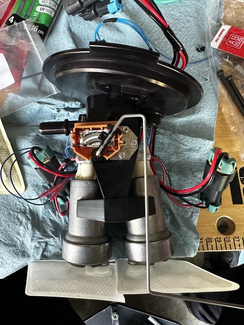

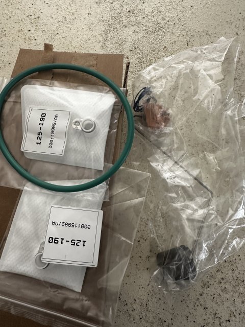

Weekend project. Waiting for a clear day in the driveway. Fuel light flashes intermittently when fuel gets near 1/4 tank and goes out. Scanned BCM and I’m getting a fuel level sensor short. Time to pull the dual pumps and change it out along with the filters. Might just be hung up on the wires for the pumps, but don’t think that would cause a short

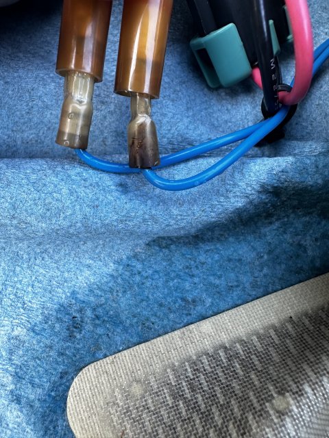

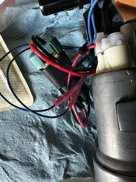

Glad I just pulled em, filters are junk. Arm isn’t getting hung up on wires, but look at the butt connections for the sensor

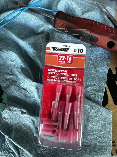

Not sure what I should use as new butt connectors. Anyone have any suggestions?

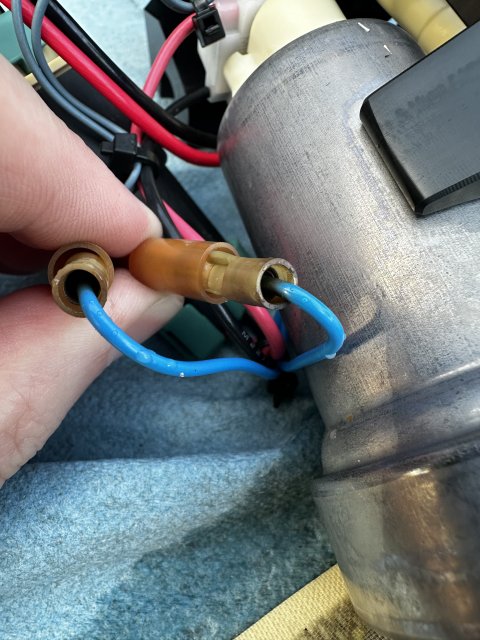

They both look burnt/shorted out at the bottom.

I've seen burnt connections in the fuel tank for pump power, the hot wires in fuel tank sorta amazed me the first time. Counting on never being enough oxygen in the tank to to create flammability issues seems like a bad idea, but it works

I'm pretty sure I just solder shrinked mine as there was plenty of wire left to do so and for any future repairs. We'll see what I do with the next card. I should probably pin and shrink it so I can make it removable again.

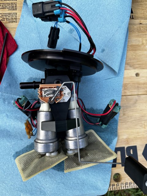

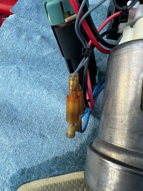

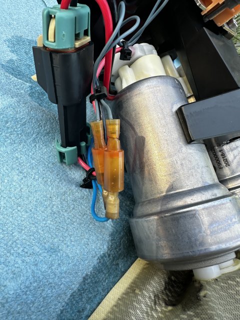

Make sure you tuck in the big stuff too. That's what mine kept getting caught on. Tuck it all good and tight. Then cluck. In a dress preferably.
