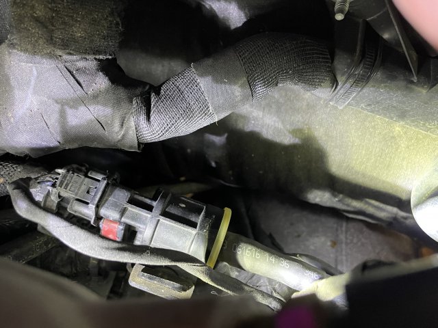

I'm going to go with fore rails and when I took my stocks rails off I thought making the jumper line larger? But the at the end of the supply line there is some kind of sensor or solenoid? The car is 2016 challenger hellcat
3,642
8,561
That is the fuel pressure sensor. Send me your stock fuel rails, and I can make them flow almost as much as the fore fuel rails for a fraction of the price. I use my ported stock fuel rails on E85 and put down almost 1100 to the tire. And with using the stock rails, you get to keep your Stock plastic valve cover covers with the fore rails you can’t use them anymore. They don’t fit on the Fore rails.

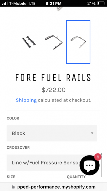

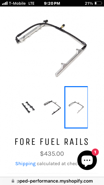

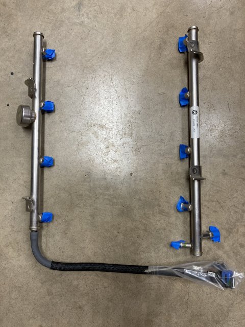

Unfortunately the Fore rails do not work like that, you have to use their fittings and sensor to adapt them in between the rails. Who did you buy them from? Rick at Tapped would have sold you the complete plug and play kit.
3,642
8,561

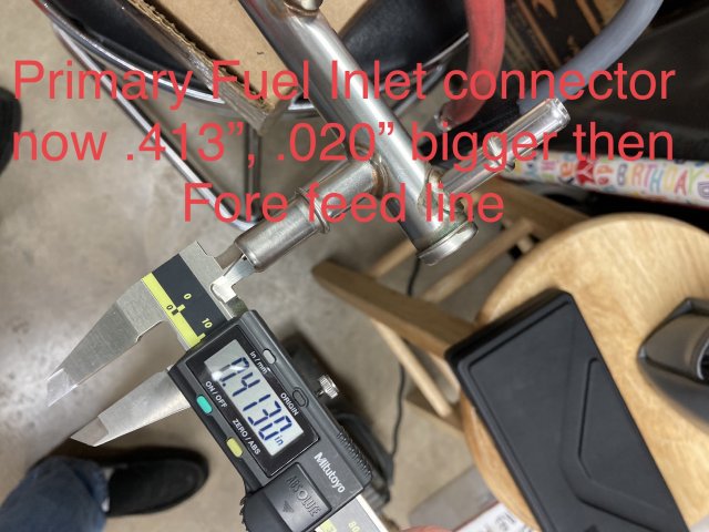

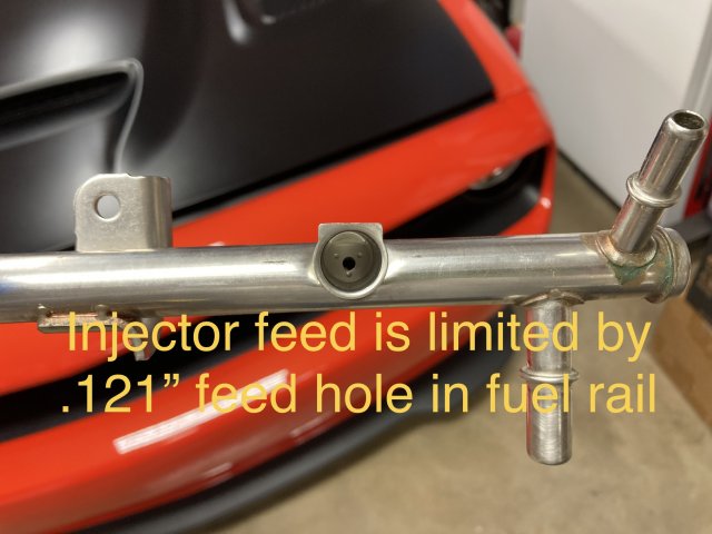

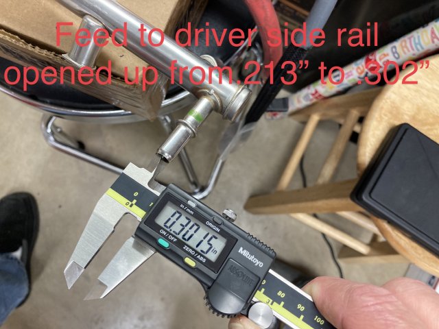

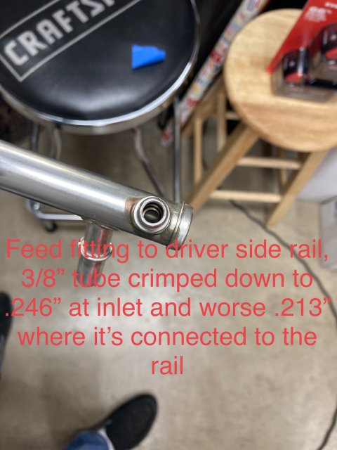

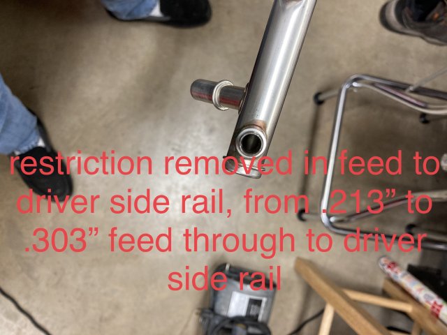

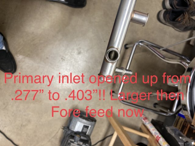

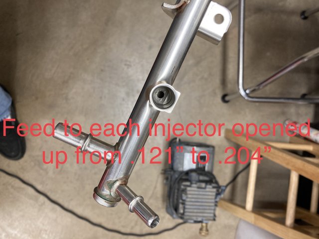

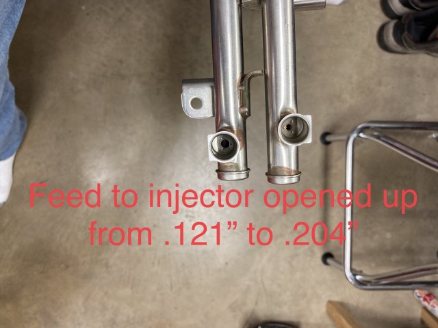

For $175 plus return shipping I could do your stock rails and they end up with the same inlet and crossover port sizes along with the same feed port size at each injector bung as the Fore rails.
IMG_3201.jpeg IMG_3102.jpeg IMG_3101.jpeg IMG_3100.jpeg IMG_3099.jpeg IMG_3098.jpeg IMG_3096.jpeg IMG_3050.jpeg IMG_3049.jpeg IMG_3052.jpeg IMG_3046.jpeg

the rails I bought was from a member in car club so I'm going to keep them.But I would to also send my stock rails and you do your thing with them? I would then compare fore and your rails at the track.And for 175.00 heck yeah!!
3,642
8,561
👍🏻Send me a message for address to send them too.
