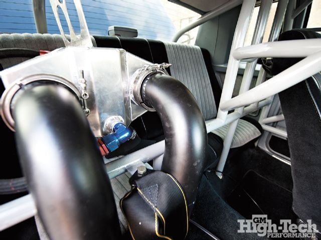

I’m looking at doing a RPM 8 point cage in my car looking to see if they will fit with gauges in a pillar. Any help would be appreciated
Picture for attention

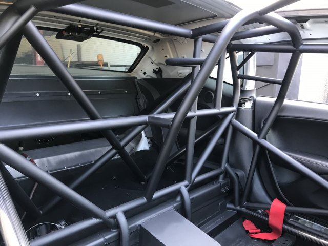

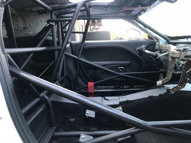

This is the upgrade to the 7.5 cert. lol. What a difference a second makes. 192CC5C7-E5E4-42D2-A605-382C4D6165CD.jpeg B8F685B7-F0D7-4ED5-BFAE-A7D1BCD08753.jpeg
