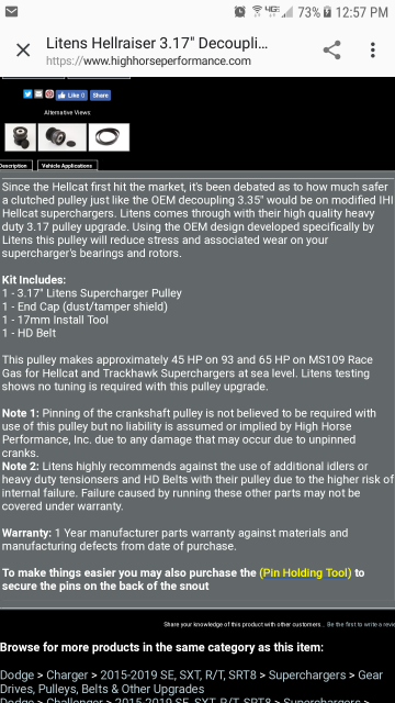

I could only make it through the first page before I skipped to the end.
When there is absolutely no company that sells the decoupling pulley that can make a guarantee about not spinning the crank pulley that says something to me about the necessity of pinning the crank.
You're already voiding the warranty anyways you may as well take all the precautions that you can to make sure you don't have a major out-of-pocket expense.

Dodge sells you the whole car without one... and puts a warranty on it, with a decoupling pulley.
I really mentioned it because of all of the "warranty" talk... if nobody remembers, when the "warranty tune" was first mentioned on the other forum... it retained the warranty. Don't be so quick to dismiss it.
