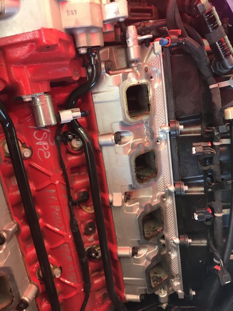

SC removed to install intercooler spacers
4,847
25,745
On the Redeye I did notice some oil blow by on the right hand bank from the poorly designed OEM gaskets.
I did not see any When we did the Hellcat.
See Redeye pictures below.

What gaskets do you use?
4,847
25,745
Diboblo
#1044
8,248
37,039
Riverside
2015 Dodge Charger Hellcat!
FI spacers have o-rings embedded, at all ports.
No need for gaskets.
Brilliant design!
