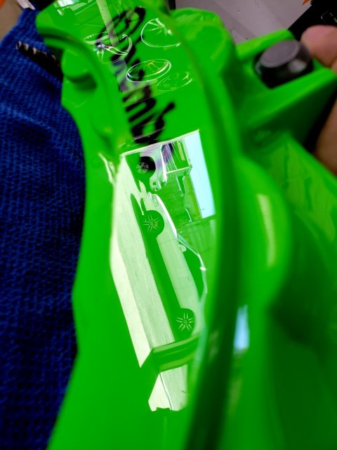

Somebody posted these a while ago, not sure if it was here or the other site. Painted with a few layers of clear.

Just be super careful if you do try to paint them. One miss-spray and they're scream and squeal every day for the rest of their lives.

Basically, just don't get any paint on the inside of the caliper, and especially none anywhere near the lube points. Chipped paint imbedded in the pad is one of the common sources of brake squeal.
