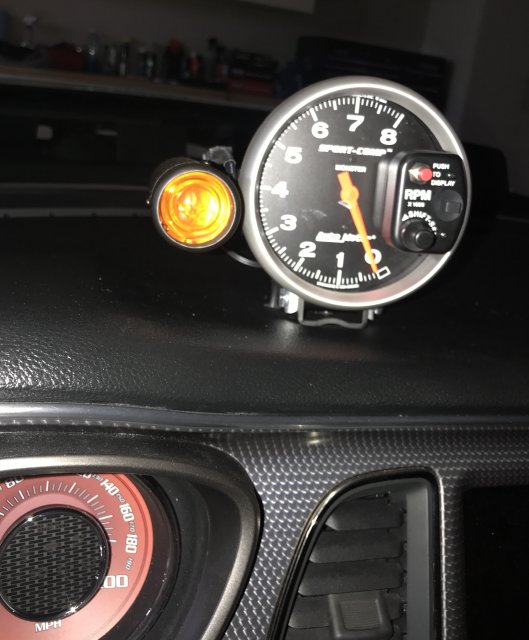

I have a Autometer tach with a shift light. Late model cars like ours require an additional adapter box wired to the coil packs for the tach and shift light to function accurately. Not a simple three wire connection like with older cars. 58EA4127-C20F-4646-8683-F6131E967562.jpeg

Thanks Marc, that’s a serious racing tach there. I don’t need anything so large and purpose built. The beauty of the Raptor is its 2 stage capability.

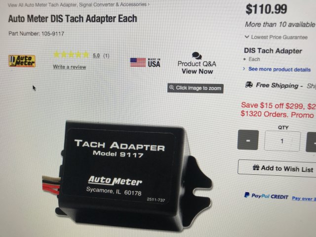

Yeah not many going this route but the point I wanted to make is I had to add an additional “DIS Tach Adapter” in order to make it work. This is required on 2015 and later vehicles like ours. I’m not familiar with the Raptor that you’re referring to but there are stand alone shift lights by Autometer and others. Before you purchase one you would be safe to check if it works with our DIS ignition. EAC489DE-EC39-4AD2-9174-DBF34BF8B509.jpeg

Will do, thanks Marc.
