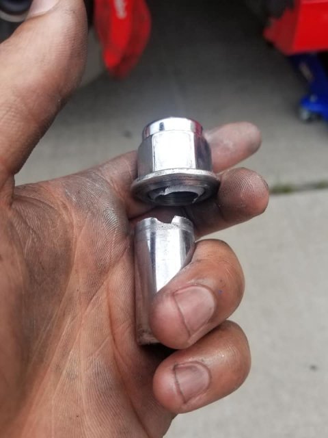

So I broke one and my friend helping me broke one. We were able to take the wheel off and get the nut off the stud with some pliers. What part number and brand would be a stronger option?

How do you “break” a lugnut. What actually broke? I heard of breaking a stud but not lugnuts?? Factory lugnuts have a sheet metal cover on them that can get dented and deformed and sometimes get separated off the actual lugnut. Aftermarket lugs for your RaceStars should be solid. You cannot break a lugnut?

They broke where the head goes to the sleeve. With a torque wrench. He broke one and I broke one. They were easy to get off the studs with pliers . Thanks Motorhead.

Just for science sake, what brand were the ones that broke?

The Racestars ones.

Racestar needs to know they have a QC problem...I would be afraid to use those on an 800 HP car!

RaceStar has had horrible lug nuts in the past. Absolutely the worst Chinese crap. I have been told that they have finally done something about it and are correcting the problem (meaning that they are providing high quality pieces now). This is second hand info as I do not use the RaceStars anymore. I have no doubt that my friend was told this directly by RaceStar but whether they are doing it or not is a good question. I would suggest calling them and telling them about the problem and see what they say.

For a shank style lug nut to function properly the wheel stud must be long enough to reach into the nut portion of the lug nut. If it's just in the shank portion then there's nothing holding the wheel to the car other than the thin 'wall' area of the shank. Threads are a natural stress point in metal as well as the relatively sharp inside corner where the nut meets the shank. That's why they break where you're describing when the stud isn't reaching into the nut.
I have never put a shank style wheel on my car so I have no first hand knowledge about your wheel/lug nut/lug stud combination. I'd personally check to see how much stud you have sticking out past the wheel and washer. The part sticking out should be equal to or more than the diameter of the stud. So.. a little more than a half inch at minimum.
Hope this helps. This sounds like potentially a very dangerous situation.

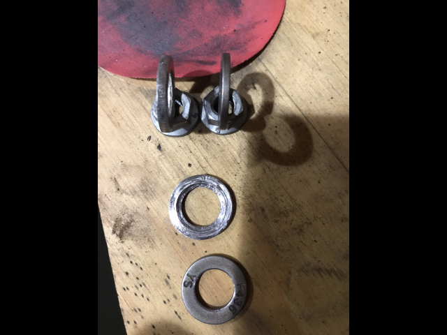

I’ve snapped a Summit one , IMO they are no better. The shank design is just shithouse and a pain in the bum . I made a set of much better quality washers that don’t deform and get stuck which helps and take a box of spare bolts/ washers/ hub centric ring to the track . D1C31CA3-76B6-45BD-85EF-73DA6EC43937.png 2AEA8AB5-720F-44BF-B142-2466A4872365.jpeg
Guys, Keep in mind thicker heavy duty washers actually make this problem worse. Longer studs are the only way to properly fix this dangerous situation.
