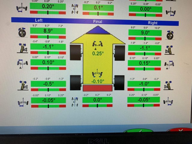

This is what was sent too me !

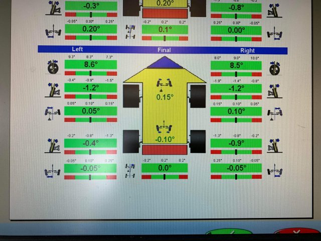

I forgot I am a little positive camber in the rear. I'm not sure if toe was adjusted or not
