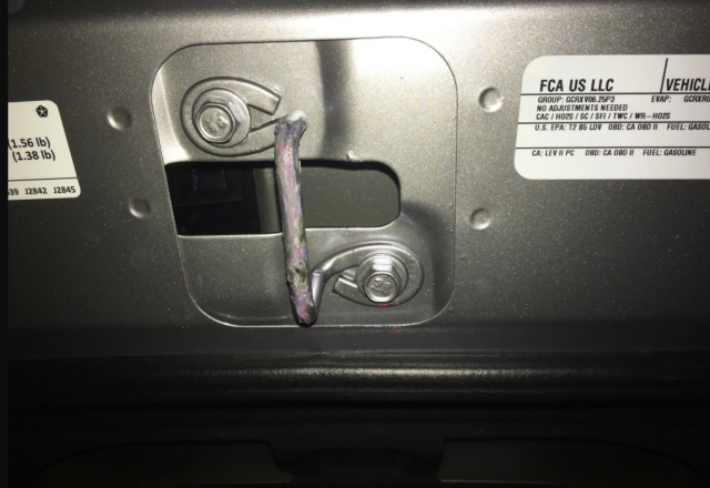

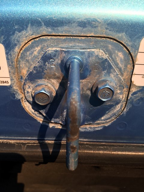

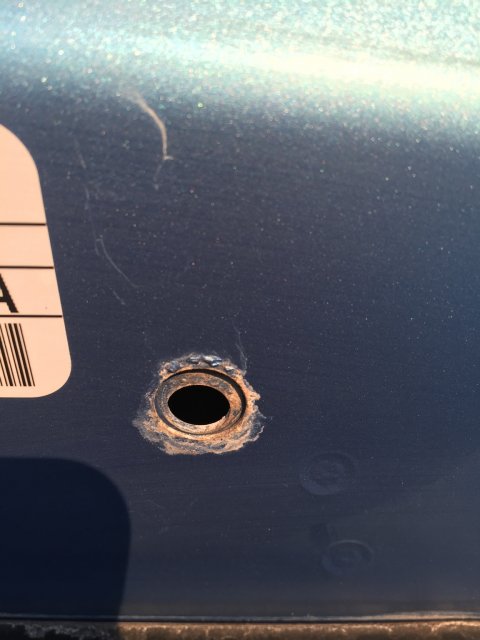

Hellcat owners should go after FCA for the improper design of 2015-2020 hoods. The steel latches/aluminum hoods are not treated properly causing a galvanic corrosion reaction on brand new cars right off the lot. You can sand and paint over but it's just a temporary fix the Dealer may do if under warranty or its on your dime. The hoods are corroding from the inside out due to a major design flaw. If not addressed it will end up looking like this around 50k miles or well after warranty is up in most cases.
Hellcat @ 600 miles after purchase.
https://www.lxforums.com/board/charger-discussion-3rd-gen-2015-/386958-corrosion-hood.html
The R35 GTR and many other modern cars have aluminum hoods/steel latches, never had an issue with others as they were treated properly. Dodge did a terrible job on these hoods, only fix is fiberglass or a carbon replacement unless they engineer a new one from the ground up.

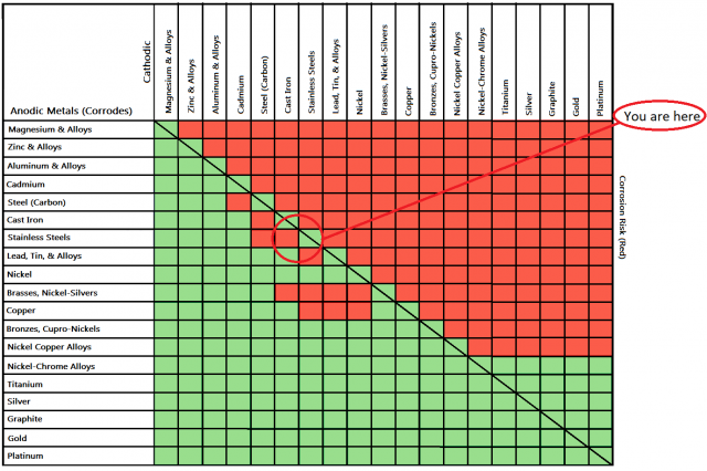

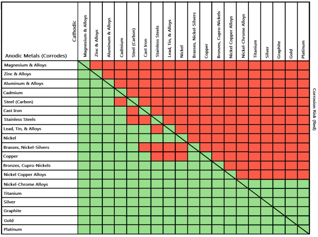

Replace the latch with stainless steel.

Yea a few have been replaced at Dealers. If one flys up causing an accident there will very likely be a recall of some sort. Matter of time really but based on the corrosion rate will happen well after warranty (10+ years) It's a trouble spot to watch out for.
You can clean it up and replace the latch with stainless but it's really a temporary fix as the hood corrodes from inside. The surrounding plate/holes will rust. Only a matter of time. Car could be spotless of rain/salt and still will happen.
My fix will be a carbon replacement. Will be set for a lifetime.
These new hoods are aluminum. I would think once the latch was replaced with stainless it should be good.
