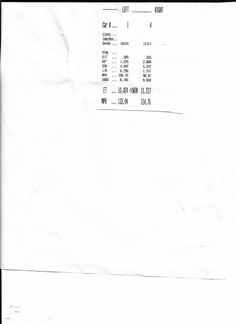

My only passes were made during the Lone Star Moparfest, and there was a hiccup in the tune, so my PB that day was 10.42 @ 133, with a 60 foot time of 1.575. The DA when I made that pass was around +2,000. Needless to say I wasn't a happy camper. The hiccup with the tune made the car feel like it was starving for fuel on the upper end, but that was corrected before the end of the day. Anybody that was racing that day can vouch for how hot and miserable it was.

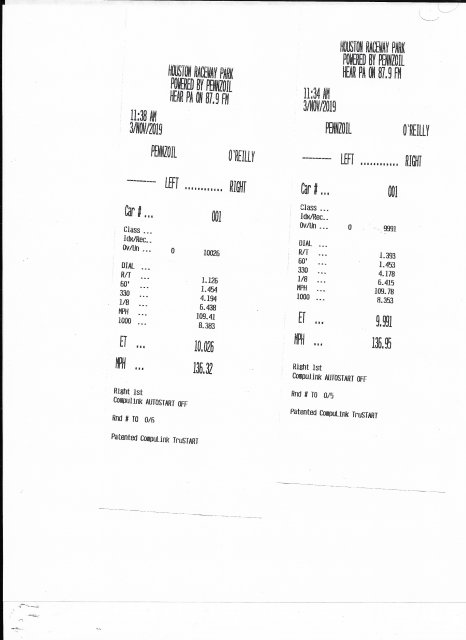

When I made my first pass today, I knew by both the butt dyno and a timeslip that this was money well spent. The DA was -325 (great for Texas) and this was a track rental, so the guys did a jam up job with the prep.
My PB until today was a 10.42. To simplify, I now own a 9 second car........well 9.991 is still in the 9's. The slip showed 9.991 @ 136 with a 60 foot time of 1.453.
I turned right around and ran a 10.026 @ 136 with a 60 foot time of 1.454.
Original PB taken at LSMF.

Passes I made today.

Great job! And I agree . I don't care if it's 9.999999 it's still a 9 second time slip!

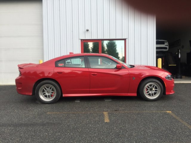

I have the HHP Drag Race Springs installed ( demon like springs)
I really like how they help the weight Transfer
Best 60 ft was a 1.37
I do not have any other suspension parts installed.

How does your car sit compared to how it did on stock springs? Seems like Chargers can sit different than Challengers as well.

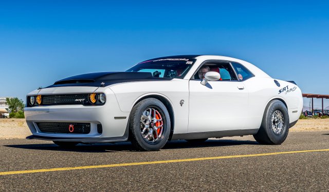

It has the 1320 springs in this picture. It sits with a little bit of a nose down rake now but the rear tires are 30.5 tall so that accounts for that. 033DF2AC-A323-4401-B68D-CEBD76A8D671.jpeg

It has the 1320 springs in this picture. It sits with a little bit of a nose down rake now but the rear tires are 30.5 tall so that accounts for that. View attachment 7634
Thanks, I wonder how they would sit on stock tires. I run 305s MT ET Rs they are 28" tall (IIRC), and eventually I may run the 315s, which are 29.5" tall. I'm wondering if a shorter tire in the rear like the 305s, might make the rear sag a little. I don't care if it has some rake to it, but I don't like the front sitting higher than the rear (Demon Killers), or the 4x4 look of the Demon OEMs. Looks really good! I know you are far from stock, but you have any 60ft data? More consistent launches? Better 60fts? Appreciate the info!

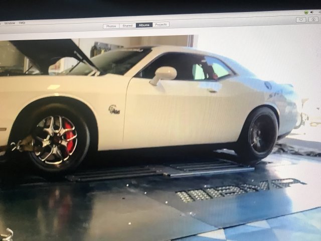

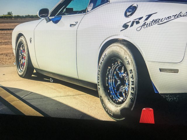

Here’s a screen shot of the car on the dyno. It’s from a video (I can’t post those here). It’s with a stock 20” wheel and tire on the rear. The fronts are 28’s also and the car sits level front and rear with the 1320 springs. I do think they lower the car a little all around though (probably due to the increased weight of the Hellcat) because they noticeably changed the camber on the front. I will also add a picture where if you look you can see that the tops of the tire are now tipped in due to this. The only way to “fix” that is by adjusting the cradle and I didn’t do that because I think it will steer better in a straight line under acceleration the way it is. D450663A-346F-4672-9F85-1AE637B8368F.jpeg DD331D87-A1A2-41E7-B8E9-3BBB77C09FDE.jpeg

That looks like they sit like the OEM Demon springs do, looks like it raised the car height quite a bit! Do you have a before picture of same wheel/tire setup? I appreciate this. Hopefully it will help people decide what springs to get, now that there are 4 options lol.
