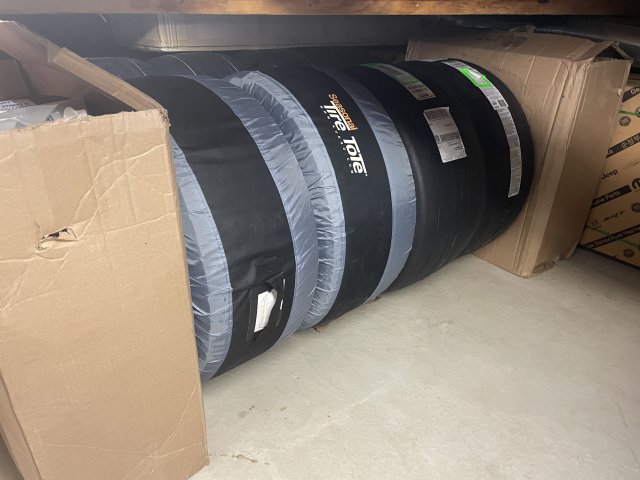

Just received my second of set MT 305-45-18
ET Street R yesterday Feb. 10 2022
I ordered them at Christmas they listed for
$403.00each
I ordered the first set last June list price $387.00 each
I Received those last October.
I Have to keep two sets on hand now.
To make sure I don’t run out of tire
They take about 2 to 4 months to receive
After ordering and keep going up in price. D9D1A19D-A2BE-4A7F-BF46-0C44EA910888.jpeg
