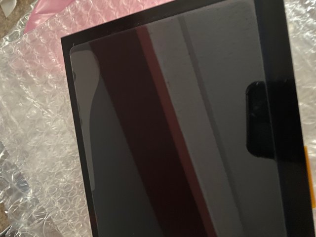

From my research, there is a common issue with MY's 2017/2018 Touchscreen's (across most FCA 8.4'' screens) where the touchscreen begins to separate from the LCD. Most people report that it starts with bubbling on the screen as if there was a screen protector that is separating. But apparently it's an issue with the glue/adhesion that was used. Also heard that this glue can become liquid-like and drip into the hardware potentially destroying other things in the dash.
It seems that people are reporting this issues more which seems to happen 3-4 years after new (usually out of B2B warranty for most). Mine started a few weeks ago with bubble at the top, then a second bubble, then they merged and just starting getting bigger and bigger. Luckily, I did not have any of the screen ghosting issues...i.e. where the screen starts pushing on screen buttons on it's own. People have reported even it triggering climate changes that can't be undone. I wanted to bite the bullet as quick as possible.

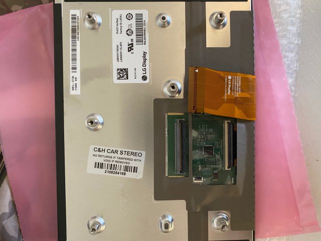

I went with the Option 2, as it was the easiest fix. Research showed that the initial Touchscreen / LCD part # ended with (1), whereas it was later revised twice to (2) and finally (3). Most people have reported that the (2)/(3) parts will not bubble or delaminate as they changed the glue. However, these two parts are harder to come by. The (1) parts seem readily available on ebay, but will ultimately delaminate again. I found a seller who had (2) part and contacted him via ebay. By the time he responded, he had sold it, but confirmed he was ordering an (3) batch, mostly for his repair business, but a few more to sell on ebay. He gave me a headsup and I ordered the (3) right away. I believe it was $650, plus tax, plus $9 shipping from CA; so it wasn't like I had to wait for it to be imported from China.

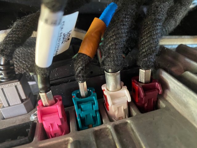

Below is a picture of the old screen where you can see the bubbling. Also is a picture of the part #3, showing the (3) designation. Also attached a picture of the rear connections should you forget where they go.
