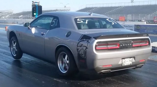

This is what results I get with Curt 1EAFE834-C067-4B71-94F9-D053657B2F78.jpeg
3,309
5,756
The curt dusteroff special
2,695
She digs and boogies. You put Demon springs in? Remove sway bar?
3,309
5,756
I do have demon springs but my car is full weight other then the wheels nothing removed at all and I also have a bwoody 3.5 race cooler on the front bumper and that’s on my lowest power tune 3.10 pulley I haven’t been able to hook on track 2.65 pulley tune just too much power
2,695
Your def getting the power to the ground with current setup. So your best 9.92 was with the 3.10 and 10% lower? You haven't even gotten to unleash the 2.65 yet?
3,309
5,756
No that was before on a 2.85 upper and 10% lower on pump gas 17 psi
Now I have 3.10 upper 10% lower on ethanol 2lbs less boost but more power the car is faster now with less boost the 2.65 nets me 19-20 lbs of boost and still 21 degrees of timing at redline
