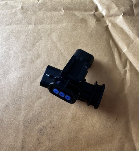

ZAutomotive inactive exhaust plugs will do the trick....run them on mine for years now after I cut out the flapper valves completely
U
8,777
7,700
CELs turned off and made my own plugs out of the same connectors for $5 to keep water out of the connectors in the factory harness
