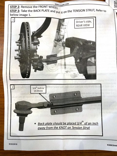

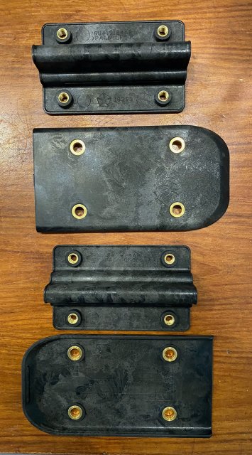

I just bought a 2019 challenger redeye. I found these parts in the trunk.
mopar says it's "Air Deflector Plate - Mopar (68419118AC)" something about a wide body mine is a narrow body... is it trash????

Those are for your front brakes.

Like Bull said, deflects air towards your front brakes for better cooling. Works fine on narrow bodies too. Do you really need it? Not really, but it definitely doesn't hurt.
