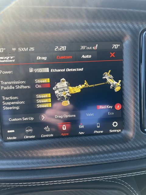

I did put some Stabil in the tank last 93 fill up - but I typically only keep 1/2 tank in the car as I never know when I'll wanna go from 93 to E85 or back again.

Walland
21 Challenger Super Stock
I went for a little ride today 37 but beautiful blue skies.
