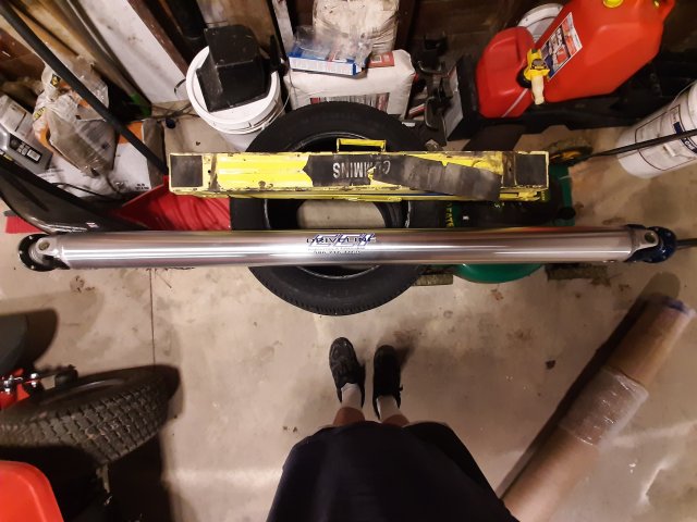

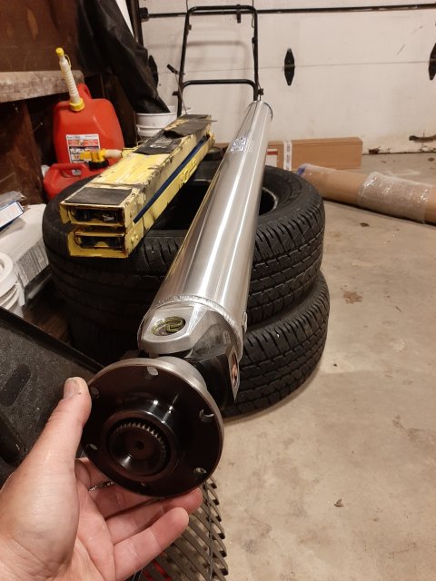

I probably would've waited for the CCI 2pc shaft. Dammit.
Oh well. Now I have the 1pc here and Beadlocks on the way. Ha.
